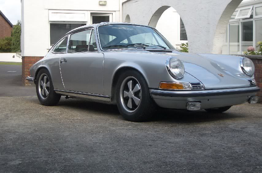

    Hello Robert,
    I found the same on a NOS set installed on a new porsche bumper. These also tilt down slightly. The pics in fact make them look more tilted then they actually are. (car in the pics is not fully finished).
    I hope they help
    Alan
    Lights
    Are yours rear mount? I have 139's (which are identical to the 169's except for mounting) and I mount them to the holes on the vertical straight facing the front - straight ahead. 139s are rear mount and the 169's are the top - 45 degree mount. You may need to get the rear mounts if your bumper does not have the top mount for the 169's.
