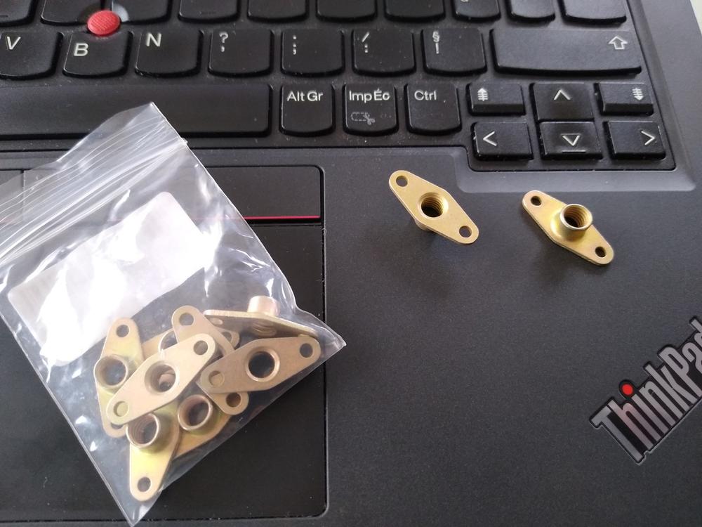

    I’ve been doing this about 10 years now. When ever I’m installing light weight Amber engine fiberglass shrouding, I was confronted with how to attach it. Doing restorations I saw the way the factory did it and decided to try another way. I got countersunk soft 1/8”x1/8” rivets and a rivet squeezer, along with 6mm weld nuts. I drill out, and plate the weld nuts to modify them into anchor nuts, then fit and install.
    Very nice finish with the rivets to hit. I use a different M6 plate I have in stock but weld nut is great too

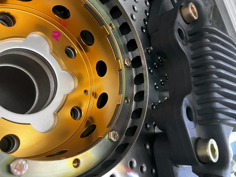

    Although I've been tracking my Martini 2.8 RSR replica project in great detail elsewhere, I like to show four of my recent favorite details on the car here.
    1) hood with balsa wood strips glued in resin and FT3 120l fuel cell with dry breaks
    2) dash in progress with custom 10k tachometer as per 917, so-called 'idiot-light' for alternator failure, 2 switches for the CDIs and old-fashioned Dymo labels as per original.
    3) detail of the separate brake hat and rear (floating) brake disc with the Zuffenhaus RSR/917 brake caliper.
    4) painted Martini logo on the door
