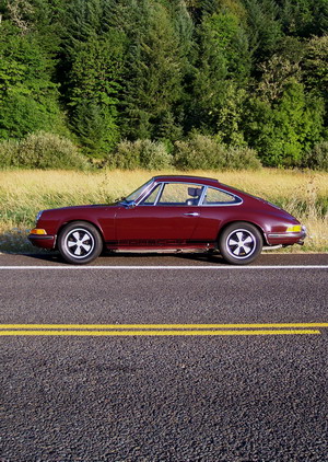

    I thought I'd post some photos of my 1970 E now that it is back together and mostly finished (for the time being). Your comments and observations are welcomed. A little history:
    The car has come back to life following a long rehabilitative process. It spent six years in my garage following the failure of the gearbox’s input shaft. I purchased it in 2001 from an owner that wasn’t quite up to the task of dealing with it. The owner had completed a moderate quality re-spray in the original burgundy, and had Gus Phister rebuilt the MFI pump. The car was complete and numbers matching, but suffered from things like worn out pedal bushings and throttle linkage bushings. I discovered that, due to the throttle linkage bushings that had rotted to the point of complete absence, the owner had never experienced more than half throttle! No wonder he preferred his Alfa.
    I had just a few months with the car prior to the input shaft failure. I removed the gearbox in order to find the source of the problem. When considering the engine and gearbox sitting on the garage floor, I allowed those infamous words that have launched thousands of expensive and protracted projects to escape my lips: “As long as I’m in there, I might as well…….”

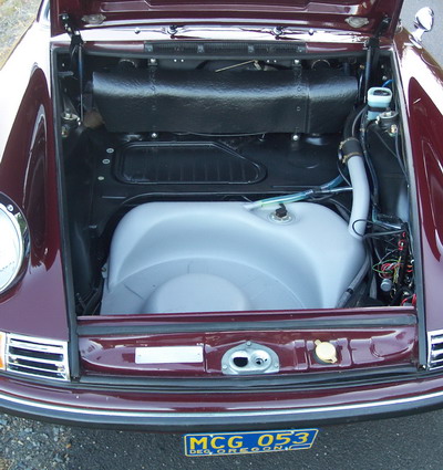

    I had to strip the interior in order to search for rust that may have resulted from the same leak that ruined the rear deck. I was able to treat and repaint some surface rust found in the interior. Following primer and paint, I installed sound deadening mat, an AppBiz RS perlon carpet set, and in a rare deviation from period-correct detailing, a black headliner. I found a pair of Scheel 501S seats (a little tatty) that I fabricated mounts for.
    The luggage compartment was a mess, with a layer of old contact cement over most of the painted surfaces. I removed all of the undercoating from the lower half of the compartment, and most of the paint from the upper half. I applied more SKS to the lower half, and a coat of satin black to the whole thing. I stripped the gas tank to bare metal and refinished with primer and grey SKS.
