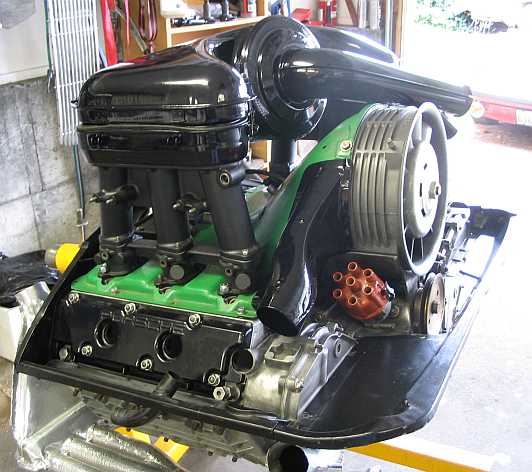

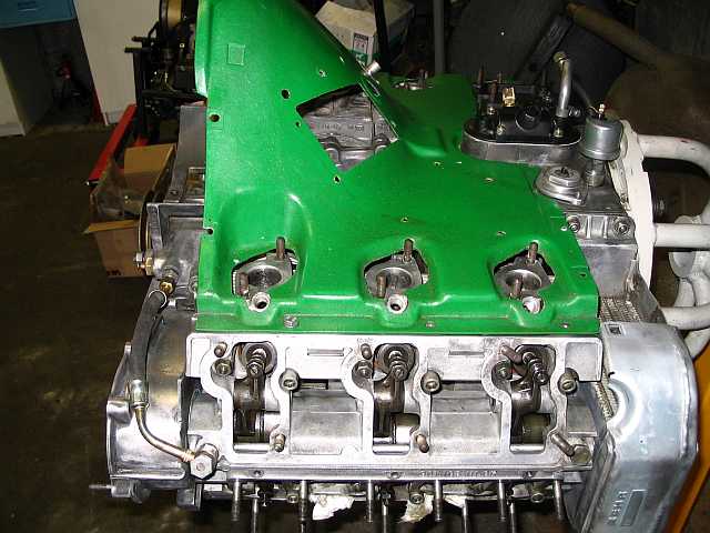

    Here are pix of my E shroud. It was in the usual greasy, scratched, faded condition after 37 years under the hood. I degreased it and then lightly sanded it, working my way down to 200 grit, than rubbing compound, etc. Basically ended up rubbing it out and then waxing it. Took me a day of grunt work, but it turned out ok. Try it out on a small section.

    Very nice Al...... great job
    Cheers
    Thanks Chuck...I appreciate it. My resto is one step closer.

    Thanks Al-
    That's a beautiful job! I'm going to try your method. Mike
