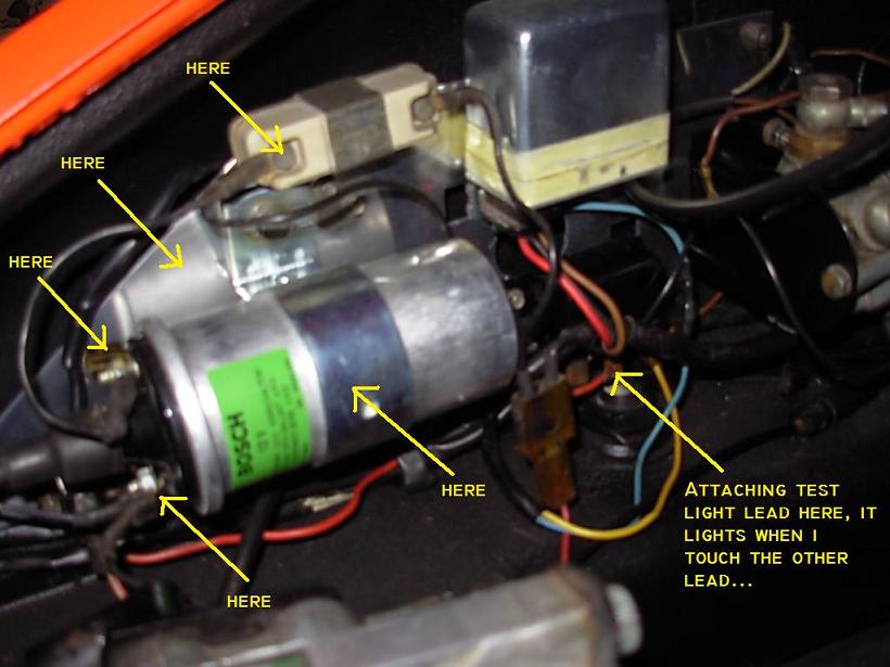

    Quick background. Car was sitting for many years before coming into my possession. Was running before we started restoration. The time has come to wrap things up and get her running. She turns over, but won't fire. Troubleshooting finds no spark. First steps included pulling a wire from a plug and then the HT coil lead led to finding no spark being generated from either location. Distributor is an 002 with new rotor, cap, points, and condensor. I've also installed a new Bosch coil. Using a Haynes manual I ran through their troubleshooting guide for conventional ignition systems. It went as follows: (i) Are points opening correctly? Yes. (ii)Check voltage across terminal 15. Should be at least 9 volts. Yes. 14.07 volts. (iii)check voltage at coil terminal 1, points closed-no volts,points open- reading on the meter. Questionable results here. I was getting a similar reading with points open and closed. The voltage reading was around 1.2v but would drop to around .6 volts when the fuel pump (Hardi) would trigger. (iii) With the ignition switched on check the voltage across the contact breaker points; points closed- no volts, points open- meter reads. Points open-no reading, then the condenser is faulty. With points closed, my meter read 0.000 and points open, meter read .015v. I also tested the coil (and two others I've got thinking even a new coil might be bad) and all three had resistance readings with were in line with what they should be. (iii) seams like it might be on to the problem, but I am not sure where to go from here. I've also attached a picture of where I've definately got power. Input is greatly appreciated.

    JT, glad you got the problem solved and car running. Now, one more question, I notice you are running a resistor before the coil. Are you sure that is needed with that coil. The original coil did use a resistor which was bypassed during cranking by the relay on the relay board. Most new coils are designed to be wired without a dropping resistor. It is not terribly critical, as obviously the car will run either way. I was just curious if that coil did in fact need the resistor. If it doesn't you might get a slightly higher voltage at the spark plug by eliminating the resistor, if in fact it isn't required.
