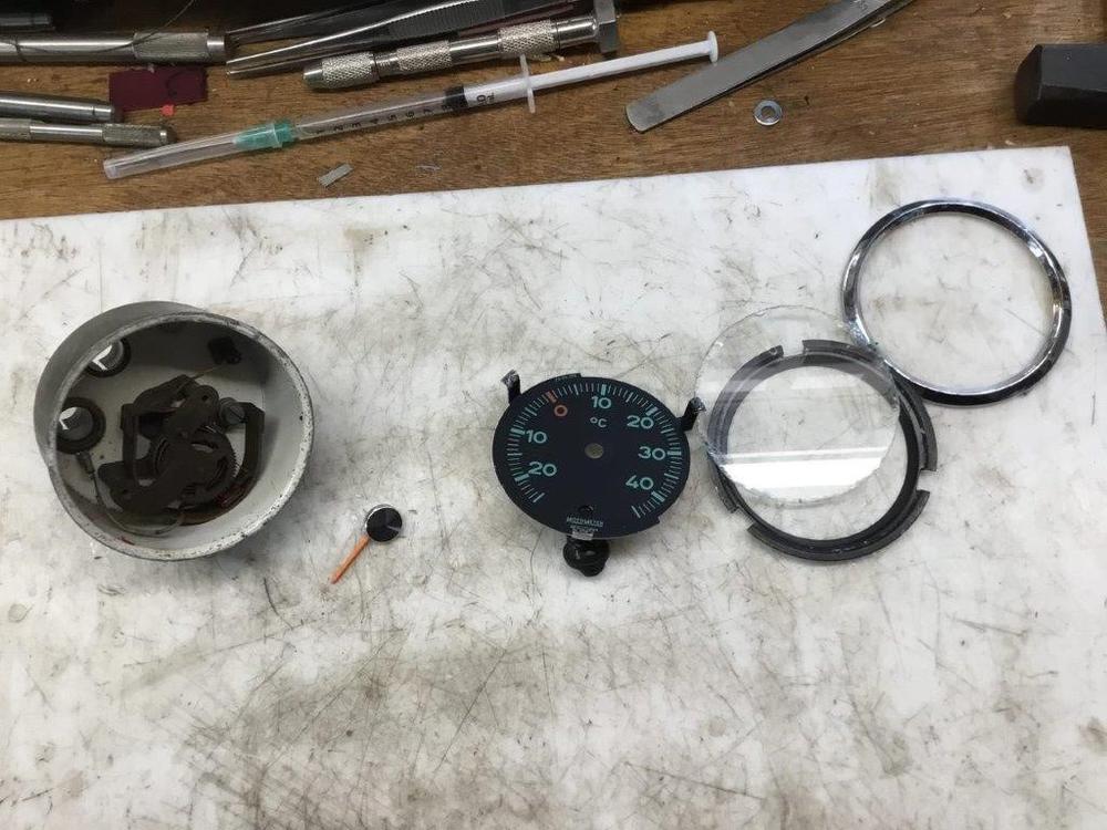

    That would be great! Finally managed to get mine working and now looking for the correct route for the sensor.
    On my gauge the sensor was cut off, managed to find a similar gauge with correct scale and had the correct dail placed in. Had it calibrated, works like a charm!

    Rick, the calibration was done by Hans Peters, he is an expert in that field here in The Netherlands. Here's his website but all in Dutch; http://www.hans-peters.nl/
    And here it is on his bench;
