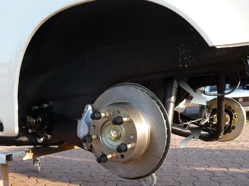

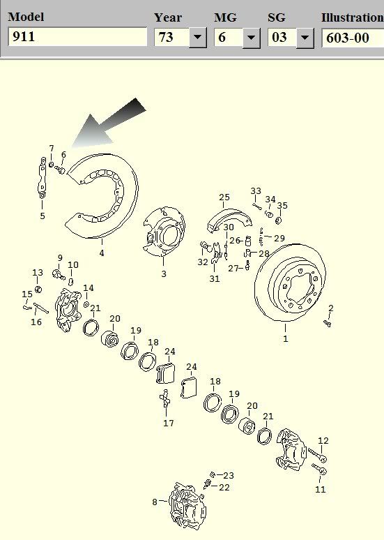

    He may be trying to fit them without the dust sheilds bracket. These fit between the caliper and the traililng arm. Without it, it off centre the caliper. Just a thought!
    HTH
    Alan

    Great pics for my reference. I will be meeting with my mechanic Monday and will ask about the bracket. I forgot to mention he is telling me that the rear rotor thickness is measuring 20.4 mm. The first thing I am going to do is measure myself. That's not any thickness I've ever seen for Porsche. If anyone else has any ideas let me know. Thanks.

    The SC pads are 4mm thinner per pad. I've sent Mike detailed pictures of the pads, my calipers and the complete system on my car. I'm baffled as to why the shop couldn't install them. I'm also baffled as to why they wouldn't simply shave the pads vs. install a mis-matched pair, or worse yet, the wrong pair.
    Mike... keep me posted on the outcome. They did mention the inner piston/pad set-up on the phone so, it could be the dust shield spacer thickness is an issue with these rotors vs. my Brembo's.
