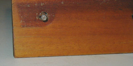

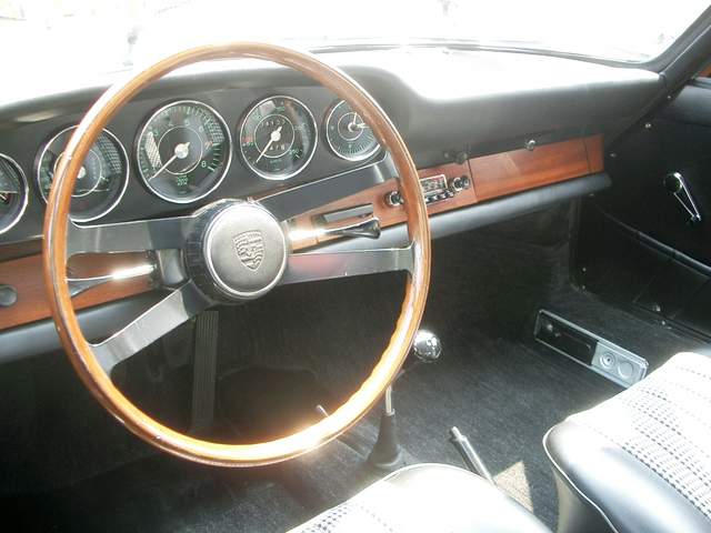

    Well, as part of my restoration of 304065 I have begun to focus on the wood dash and steering wheel. Has anyone used Bruce Crawford for the wood? I understand from his web site he does the dash also.
    I am trying to figure out what species the dash is. It's commonly known as "teak" but I believe it's not teak at all, I think it's quarter-sawn mahogany.
    Here are some photos. Bonus if you guys can guess which cars they are.
    The last attachment is a sample of quartersawn mahogany veneer that I am going to get a physical piece of to check against the dash. The dash consists of the aluminum wraparound piece (not present in 232 cars) with a plywood insert and the veneer laid over the top. I think it's possible to soak the wood in solvent to dissolve the double-stick tape that's probably holding it in the aluminum channel- wetsand and polish the aluminum, put a new veneer over the wood, stain to match and put the whole thing back together.
    Or maybe I'll just send it to Bruce Crawford!
    Can anyone offer insight into the wood species? Has anyone restored their wooden dash before? Thanks in advance for any contributions.

    How are you? Hope the restoration is going well. First off the wood is mahogany. It's not necessarily quarter-sawn but for sure it's not figured.
    I wouldn't soak the wood in water or any other liquid for a period of time. It will cause swelling and warping. Kind of like throwing your first edition Hemingway in the tub. I had good success restoring a couple of pieces of my dash on the '66 I owned. Do you remember?
    I would also hesitate in replacing any pieces. This wood was harvested at least 45 years ago from trees that were god knows how old from god knows where. Finding a good match could be difficult. There's a lot you can do to get rid of stains and discoloration. You'd be amazed. If you do need to replace and match, I'd take it to a speciality wood shop and ask the pros what species it is and get some samples. Each board is different. Optimally all pieces should be cut from the same piece of veneer, in order, so the grain and color are continuous.
    I can send you before and after pictures and the process by which I did it if interested. Good luck.

    take a look at African Mahogany for a grain match. Rockler Woodworking is one source but a local to you source is always better for that 'eyes on" match.
    The original color can be viewed under the ashtray handle. When I saw photos of Alois' dash I was taken aback as how cherry color it was. So when I took my ashtray apart I was pleasantly surprised on how good a match he did. That orange is just faded out stain/wood.
    There is a 1966 wood dash with the aluminum surround that does look like it is teak. After all the car reviews calling the mahogany "teak" (THE wood of the danish modern 1960's) it looks like at one point a dash actually was teak (with it's slight green cast to the brown).
