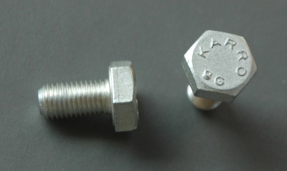

    Here are two.
    The first is from my '65(#301111), it's a KARRO 8G. This is the original paint on them.
    The second one is my '67, also original paint on them.

    So I dug through my plating and found two short Karro 8G's that are fine thread. So that must have been original to the car. The car had half of the missing when I bought.
    I hope you all appreciate the quality of the attached photo. I got out the Nikon SLR.
    Thanks for your help.
