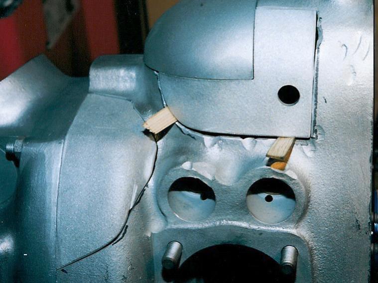

    Photos courtesy of Richard Sheckler BMW VMCA .
    This is a rare engine and the only reason it was saved. As you can see somebody got a little angry with it.
    The welder did an admirable job but the real prep was "dressing" the work.
    Tom
    Early S Registry #235
    rgruppe #111
    Dec 2008
    Woodland Hills, CA
    2,381
    And of a bigger importance, the repair has been documented with photos.
