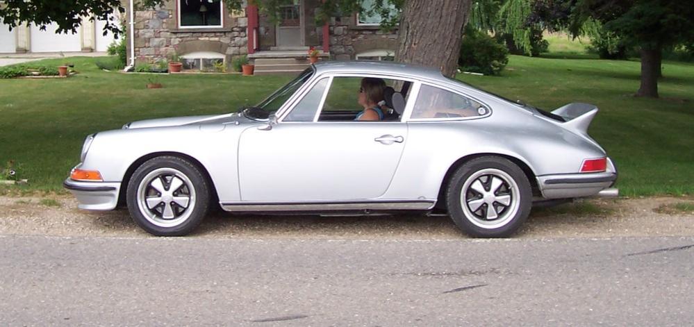

    For example, I'd like to lower it about like this car (love the color, flares, RS touring trim) Chuck, are those 50 or 55 series tires in front? From what you say in the post where I got this pic, you're at 23.5 in the rear, so I could go down .75 in back. Just not sure about the front.

    Quote Originally Posted by EsGeht View Post
    I guess to get that really good looking stance I'd need to have taller profile tires stuffed up into the wheelwells in order to maintain some reasonable ground clearance, as opposed to low profiles that lose ground clearance just by their size alone.
    This is my experience for sure.
    Chuck's car, IIRC rund 225/50s at all 4 corners.
    Also, be aware of rear clearance, too. My car when is was low on 225/50s dragged the trans and engine case on the speedbumps at the Flamngo Hotel in Santa Rosa, during Treffen a few years back. It wasn't fun trying to take every speedbump at 45 degree angles!

    Mike,
    I think that's an earlier pic... for sure those are my racing wheels, but I think I was still on 205x50's in the front.
    Have plenty of pics with the 'new set-up' w/225's all around... will post later
    Kenik is right........ EVERY driveway, bump, and slow dip was a problem... especially with the 205's in front. The 225's in front help... and also the new stiffer suspension.
    Also, my car has had rolled inner front fender lips (from about 10:00 to 2:00oclock) for most of its life.
    Have the tires you REALLY want on the car when you do your set-up, you'll/they'll set the ride height first then the balance and alignment...... take your time.
