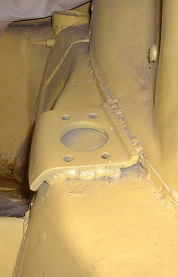

    Does anyone have any information about the Threaded Plate (Item 8) used for Roll Cage mounting on early cars.
    I believe that they were 8mm thick and tapped M8 but seem to have a bend which difficult to understand.

    Here you go.
    Images 1: repros fabbed from steel plate
    Image 2: NOS cast steel top and steel plate repros side-by-side
    Image 3: another side-by-side comparison

    John, what is that?

    Nice work! Here are the originals. Must have had a heck of "break" to make those bends. You didn't do it in the back yard with vice-grips and a hammer.
