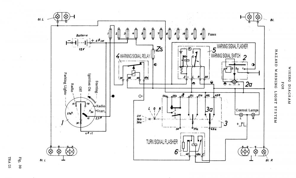

    And now for the Piece de Resistance. . .the Factory Hazard Circuit Logic!
    1966 911 #304065 Irischgruen
