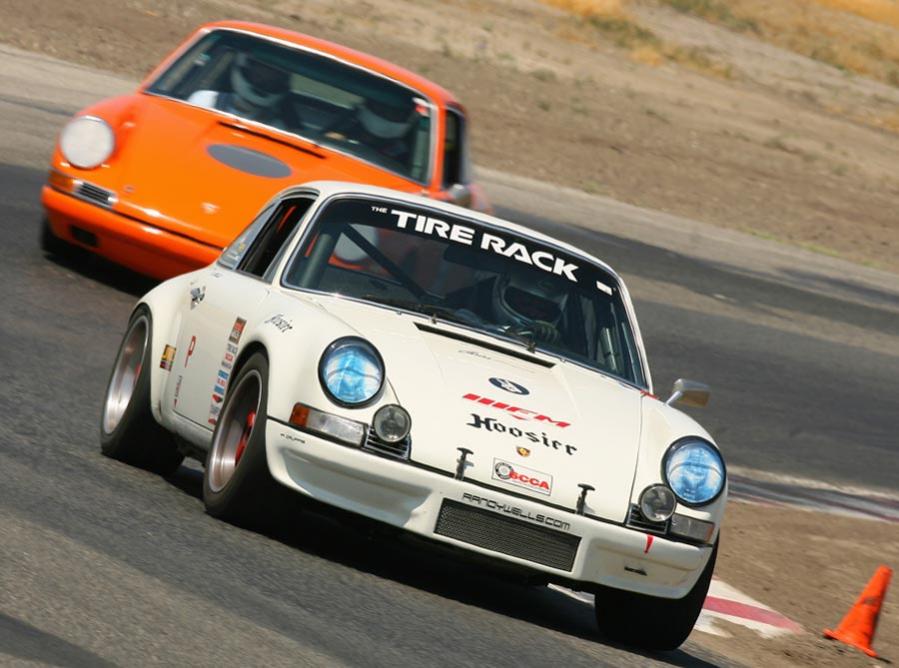

    The ST front RS rear eventually looked a bit odd to me too. The only reason I went this route initially was I already had the "massaged" RS flares on the car and wanted to keep the cost down. When I decided to repaint the car recently I went with ST flares all around. Much better look IMO. The car is not finished yet, but here are two photos (not mine) for comparison. The track shot is from Buttonwillow's photographer in 2009 and the newer shot is from my LA body guy, Steve Hogue, last month.

    Funny, with the front quarter shots, it looks good to my eye.
    Maybe if I saw the car in the metal, looking down at it from my standing height it would look odd.
