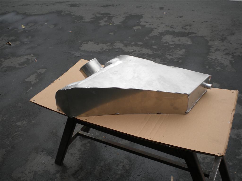

    very very nice. this is a stainless one that came out of a german 72 , manufacture unknown.

    do you want me to check the capacity of mine and some dimensions
