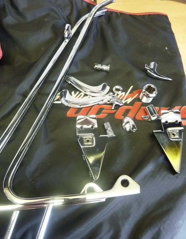

    Hi Scott, the easier option is just remove the rubber section and re-chrome. We have restored/re-chromed lots of pre 68 window trim so if it helps I can send pics. For now here are some from a US 68 car. These were stripped and re-chromed last week.
    HTH
    Alan
