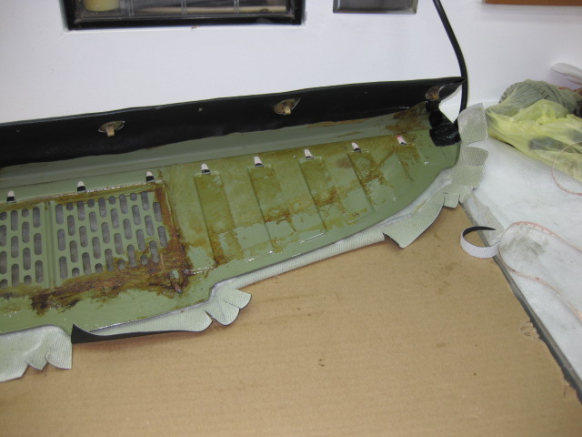

    I recently finished recovering my '67 dash and thought some pics of how it attaches might help... Two nuts as mentioned (those bolts best seen in the middle pic at an angle), accessible thru the trunk area. As well, five clips - one on the driver's left side, plus four across the front by the passenger side.

    Great photos...Thanks Patrick!
