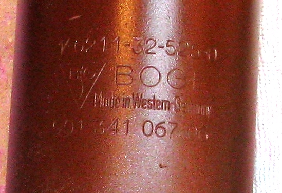

    OMG, Mark posts! Yep it is me. Yes, they are marked Boge on them. brownish orange, do you have a pic? Is it the color of these inserts? Thanks.

    Update: I am informed that the SWB Boge struts are all (not the cast iron bits at the bottom) red/brown...see photo. Further, I learned that Rustoleum "Professional" #7569 is dead match for the original..after a coat of clear is applied, since the 7569 is flat. Thanks to my friends on the list, now we know! Thanks.
    -Allen-
    PS The color on the inserts looks too orange, like a Koni orange
    PPS. This photo from my good friend Richard, "304678" I found, not from Richard, but on a Google images search...small world!

    I don't see a date code. The identical struts are each stamped T41 and Boge is cast into the bottom casting. The caps are stamped with the Porsche and Boge part number. Update: I found date codes on the caps. 667 and 567. Perfect! my car came off the line in late November 67. Thanks.
