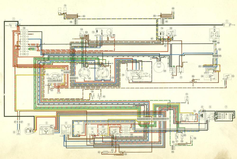

    Lastly: Also, what color is the wire that should be connected to the enrichment solenoid? Wiring diagrams I've seen haven't helped much and no obviously loose wires are back there.

    There is no "enrichment" solenoid on a 71 MFI, there is only the overrun cutoff solenoid. It's a gray wire with a red stripe. Do you mean the cold-start solenoid? It's a gray/white wire, goes to #12 in the diagram (where it is called "electromagnetic control valve.)

    Yes, I mean the "cold-start" solenoid, not the overrun solenoid on the MFI pump. Thanks much for the info, which helps a lot. I wasn't clear on which was the cold-start solenoid from the wiring diagram legends I saw.
