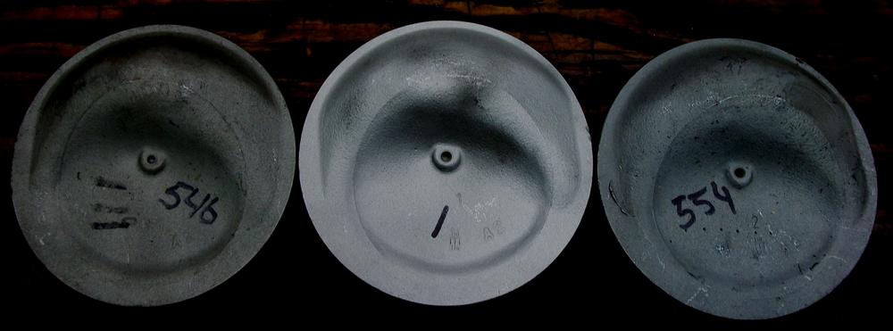

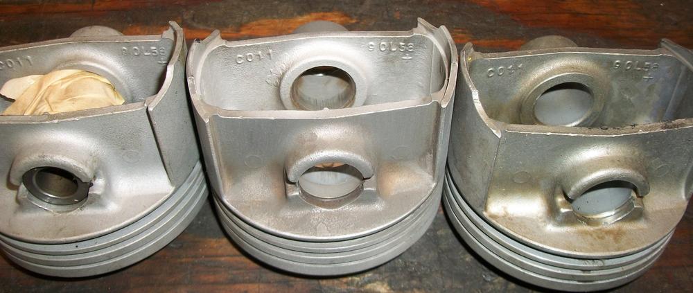

    Here's an example
    The pics show (3) Mahle 90L58+ pistons. These are 2.7 8.5 CR Nikasil pistons.
    The crowns show the size group markings "0", "1" and "2" clearly stamped.
    Note the 90L58+ forged markings are the same for all (3) pistons.
    I would love to know what the "+" marking does mean.
