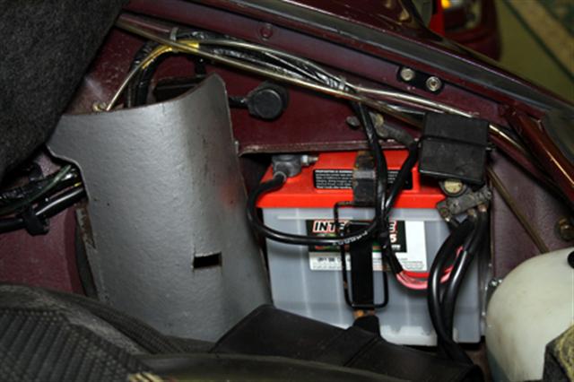

    I replaced my dual lead acid batteries with a single optima on the drivers side. I have not noticed much of a difference in handling on the street or at Autocross.

    Boxter03, what is your battery setup? I see they are Interstate brand. My local suppliers sells Dekka batteries and I know this is old info, just wondering if there is anything new.
