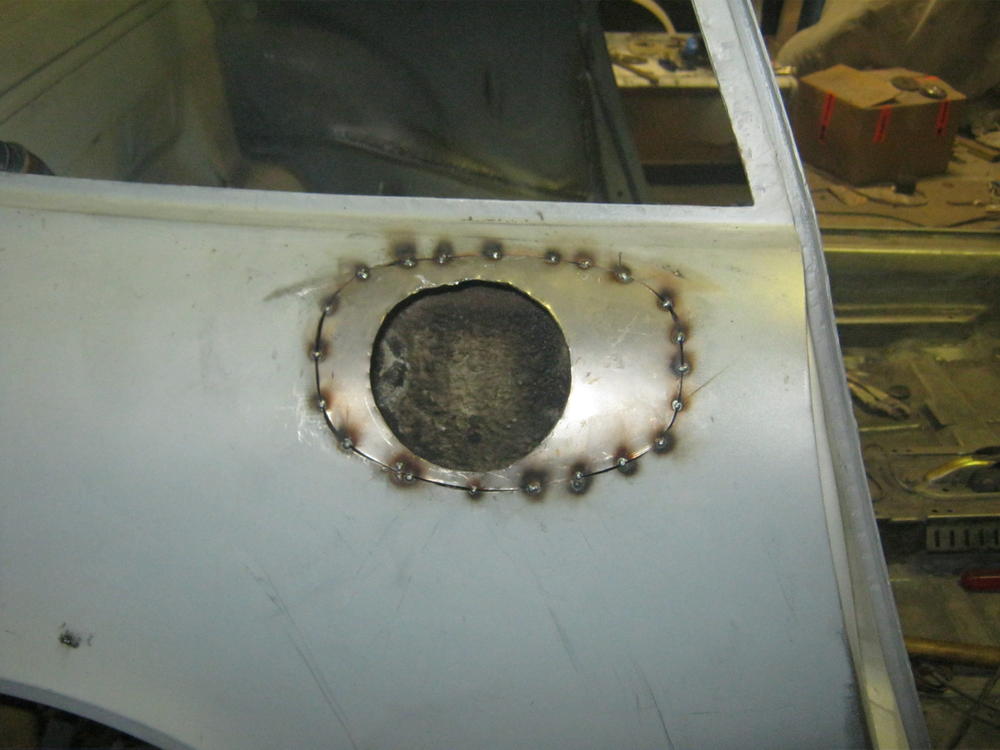

    More body work with parcelshelf replaced and dented side reworked.
    We also added the thru the body oil cap, since it was a 72 body this was the easy upgrade.

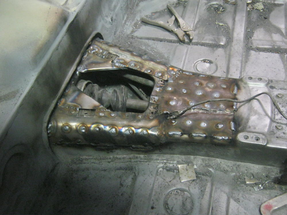

    Some reinforcements

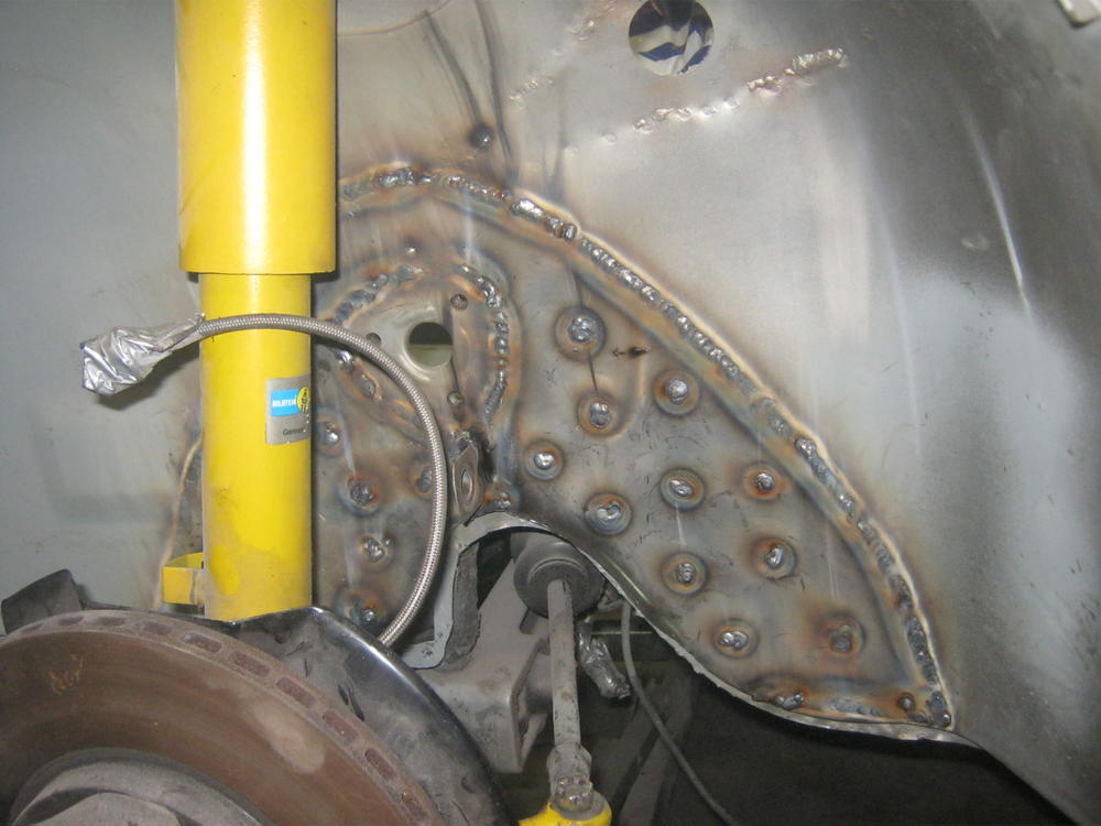

    Some more reinforcements....by now the car is getting heavy
    So we had to loose a battery
    With the 72 chassis, placement of the oil catch tank had to be a bit different than with the earlier chassis since the shock towers are placed differently. (and have reinforcements here) We also added a bracket for future dual coils should we want to go that route later on. The big plates are for safely mounting the seatbelt inertia's on the parcel shelf.

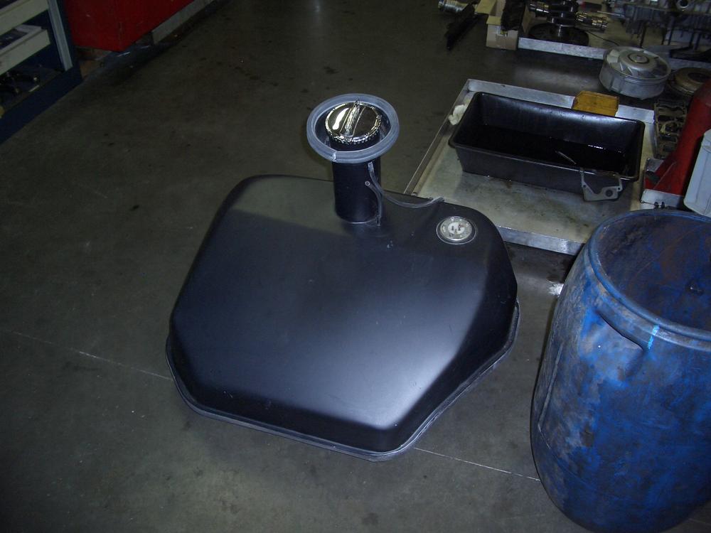

    After some really sparkling color scemes for the car, we decided to keep it low key and have decided for Dolphin Grey with Slate Gray wheels and stripes. We also molested a standard tank to a bigger centerfiller tank
