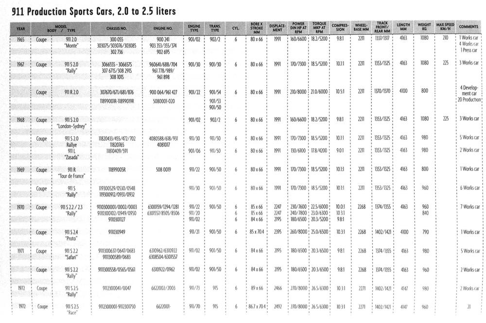

    Can anyone help me identify which book / reference document this table is sourced from?
    Name:  ST chassis list.png
    it is obviously a German language publication. I thought that it was from Boschen and Barth but when I checked my (English language) version the tables are similar but the one published above is much more detailed with a lot of extra information. It possibly comes from another version (or maybe the German language version) of the same book but the differences in information are substantial. For example looking at the 1970 werks ST's this table shows 7 cars, the chassis numbers and engine numbers. My book shows only 5. I know this table has a mistake on the TdF car (should be 1127 not 0949) but overall it provides much more detail.
    I have a copy of a similar table for RSR's etc (obviously from the same publication) that again is much more detailed than the Boschen and Barth book i have
    A part of the reason I would like to know is that i have been trying to establish the identities of each of the 1970 werks rally cars and the events they participated in in 1970 at least. This table above lists a chassis number (0102) which I think may be for the orange car registered S-T 5158 which was entered in the 1970 Swedish rally for Waldergaard (although the Swedish rally seems to have been the only Werks entry before it went to various French drivers with close factory ties).
    If 0102 is indeed S-T 5158, and if the table above is accurate as to the chassis numbers of the 1970 ST's, by a process of elimination, the 7 werks ST rally cars would have been:
    911 030 0001 S T 5704 first event:1970 Monte Carlo; car #6
    911 030 0002 S T 5705 first event: 1970 Monte Carlo; car #2
    911 030 0003 S T 5706 first event: 1970 Monte Carlo; car #11
    911 030 0949 S R 2970 first event: 1970 Austrian Alpine Rally; car #3
    911 030 0950 S R 2971 first event: 1970 Swedish Rally; car #9
    911 030 1127 S U 9370 first event: 1970 Austrian Alpine Rally; car #4
    and
    911 030 0102 was S T 5158 first event: 1970 Swedish Rally; car #2

    This is from the German edition of the Barth/Büsing 3-books series 'Das neue große Buch der Porsche Typen', 1. edition 2005, book 1, page 492

    Michael
    thanks a lot
    now comes the challenge of finding it
    thank goodness for search engines
