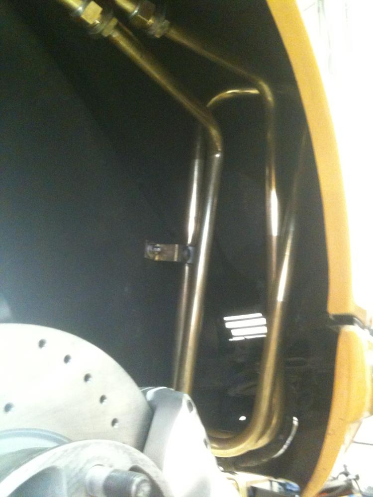

    Yup. Elephant Racing oil lines and trombone oil cooler. One more bracket was added to the cooler. I don't have a picture of that at the moment. The SWB Elephant lines where strait forward.
    For more pictures on the car go to Community on the tool bar then Albums then 912P. The P stands for POLO a 4 cylinder 911 engine, so this 912 has a rear fender oil tank and plumbing like a 911.
    Chris

    I also did a front cooler install on my 67S. Basically I used the 69-71 oil thermostat console, SC oil lines, and the 3.2 Carrera cooler. I wanted the early oil thermostat console so that the oil lines would route over the top of the tire, since with 7" rims there isn't enough room for oil lines between the tire and inner fender. I believe Elephant has made lines for a later thermostat that will also route the lines up over the top. I had to have special fittings welded up to make the attachment to the SC oil lines. One of the SC lines had to be modified with a 90 degree corner cut from an old trombone cooler sweat soldered in to help it make the corner up to the front fender well. The fender joining panel is different on cars up to end of 71. To mount the oil lines to the rocker I install weld nuts into the rocker and then can use a 6 X 1.00 threaded bolt and plastic spacer to prevent crushing the bracket. (I hate sheet metal screws!) The cooler is mounted using a lower bracket and an upper bracket welded to the back of the headlight bucket. Although not on yet in the picture I do have the louvered plate installed. The louvers are an important part of the cooling air flow. How does it work???? Well in two cross country drives sometimes in 100 degree ambient, and running 75 to 90 mph I've never seen it go above 195 degrees. Once in a Loooong Dallas traffic jam in 100 degree temps it got to 210. As soon as I got rolling it came right back to 190. Most of the time in normal temps It won't go past 185.
