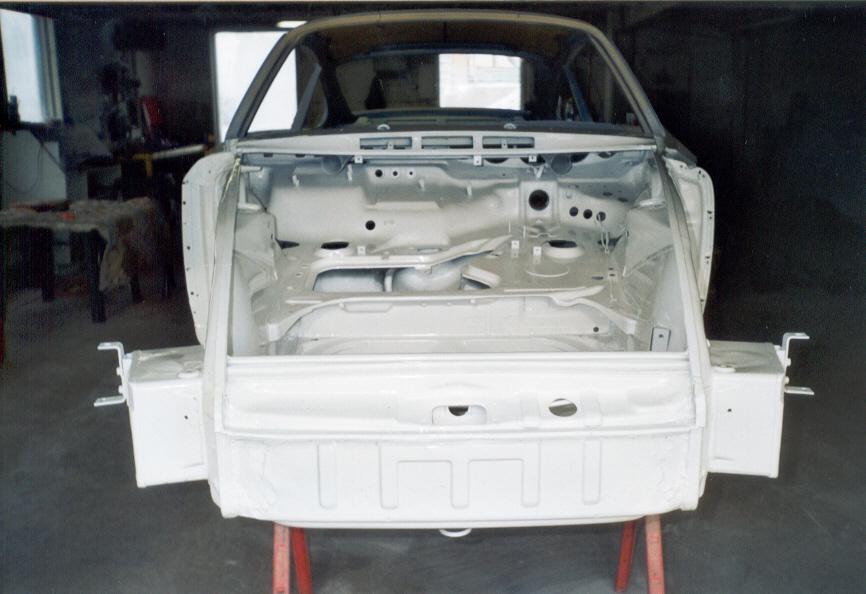

    Scott, I took this picture of a concours restored '73 RS a few years ago showing the paint line... YMMV.

    My 1973 RS has the paint color in the engine bay and my 1970 S has the engine bay painted black. I think your understanding is correct.

    Most helpful. Thanks to all- especially Bill, Mike, denson and 78mochasc - for the pics!
