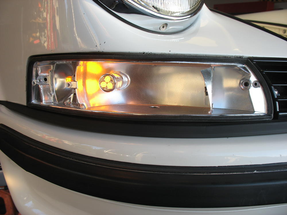

    LEDs work great, but as indicated above you need to change out the flasher and make a minor wiring change. All very simple. Here's some light reading for you:
    http://forums.pelicanparts.com/porsc...r-problem.html
    http://forums.pelicanparts.com/porsc...ed-lights.html

    I did this to all 4 corners on my 71 plus license plate. Looks great. Very bright. Easy upgrade.
