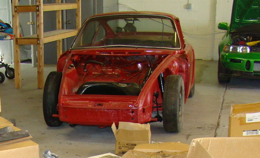

    I am just starting the restoration of a 911 SWB chassis number 305119. I bought this project from an posting in Panorama. This should be an interesting project and i posted a couple of pictures. I have restored a 356C from parts so I am not new to the process. My intent is to restore it as close to original as I can. I do have a few initial questions:
    What books or other documentation have been found valuable? I have the Porsche shop manual but I would like more information on originality.
    Is there a good source for original colors? My chassis has been painted and I believe that the non-exterior should be black.
    The gauges are not the same color, green tachometer and white speedometer, which is correct?
    I will do some more searching of this forum but there are LOTS of postings, many, many fore than the other boards that I have posted to. I'll post detail questions when they occur.

    WELCOME to the Forum. You will find many friends here.
    A few observations and answers.
    Save that Sydmur Fireball, those are pretty rare. They are an early commercial form of capacitive discharge ignition before the factory's in 1969.
    Yes, the chassis should be all satin black. That is a separate discussion in itself.
    What is the original color of the car? The color code can be found on the paint code tag on the forward driver door pillar. Do you have the Certificate of Authenticity from Porsche? It is also found on the COA. COA are not perfect and expensive, but a must have for a serious restoration.
    Gauges had green lettering until the 1968 year. On the back of yours, there is a date stamped into the metal for production, and another date stamped with blue ink for Quality Control.
    The factory workshop manual is a good source both for technical information and how the original prototypes and early production cars looked. The PET parts diagrams contain the updated, superceded part numbers, and the illustrations are good enough for assembly. For originality, a factory parts book or a repro is very important.
    Do you have the engine and transmission? Interior? The project looks mostly complete, I would start by cataloging everything and then looking for rust. As a 356 guy, you know the drill.
    Again, WELCOME. As you dig into the project post your questions here and tag them with "add/edit tags" at the bottom so you can easily find all the answers.

    I spent most of today sorting through and inspecting things to formulate my approach. One of my discoveries was that the suspension was just slapped on to make the chassis a roller. So, the suspension must come off to insure that the rubber, seals, grease and torques are correct.
    I was afraid that I would hear that the stone guard surfaces should be satin black. One more task for the list.
    I have a transmission, 901/02 (from a 911S). The project had a 911S engine but the previous owner is selling the engine separate. I have bought a 901/05 engine which is about 700 serial numbers from what probably came with the car. I'll order a COA after the title has been transfered.

    A morning questions after looking at the recommended threads.
    Is the fuel tank "356 engine gray"? My car has undercoat in the trunk, and passenger compartment (see pictures above), should those areas be smooth chassis black (satin)? I first thought of just painting the areas but then I thought about the installation of the coverings and figure that it all must go. I assume that the undercoating is correct in the fender wells and the underside.

    Quote Originally Posted by JimVillers View Post
    Before jumping into any painting, I would be sure the undercoating is correct...By the looks of it you may have to go back in many areas if you are looking for originality.
