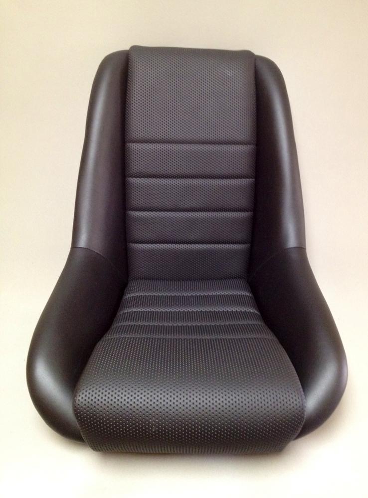

    I, too, have the original seats in my car. They are showing their age and no longer have ANY support on the front edge of the seat. I started looking at my options and also wanted to go the 'sport route'. After having a chance to see some of the www.vintageseats.com in person and sitting in them, I wish I had not put up with my originals for so long. My new seats from VS arrive Friday. Even if you dont go the sport route I encourage you to take a look at VS and give them a call.
    my new seat....
