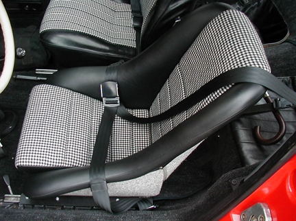

    Stock style belts
    These are the stock factory 3 point seat belts - 1964-1965. I've re-webbed them. The lap belt ends are floor mounted just to the rear of the seat, and tuck under the rear floor mats. (The stock lap belt mounts moved with the install of the roll bar mounts). The belts work very well with the 911R seat (from TRE). And, they don't interfere with the fore-aft of the adjustable seat slides. (They replaced racing 3" with the buckle latch...old habit...)
    They are period correct hardware (with black re-webbing rather than the grey) and actually function quite well. I've got about 8K miles since they were installed and am very happy with them.
    As an alternative - some of the best retractable seat belts are from the E30 BMW from the late 1980's - trim in scale and very easy to use - mounting would have to be custom to fit the 911 B post mount. Take a look you might like 'um.
