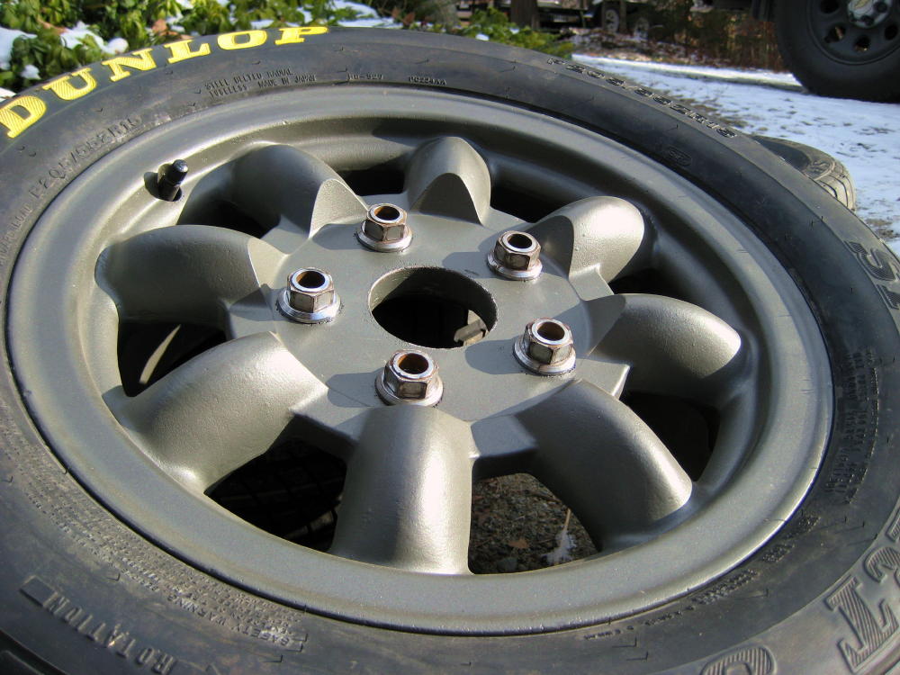

    Greg, here is a shot of my first generation Minilite mags. They were lighter than Fuchs but not Mahles, but as Chris says, strong as hell and stiff. The finish is rough sand cast raw, but rang clear as a bell when tapped with a small hammer. In fact, they were as-new when I got them. This with two coats of zink chromate primer and two of old Chevy cast iron engine gray metallic enamel. The Dunlops balanced up with very little lead weight.

    I like yours Jens, they are a different style apparently, your spokes are cut off towards the center and you have a flatter center portion, they look rough but if they are light, I'm fine with that. My beef with my set is that they are neither cheap, light, fit the car well, or well finished. *One* of the 3 would have been OK, *none* is a bit annoying and I cannot see a single reason to recommend those for any use. But they will go on the wife's 912 and she likely wont notice the difference, much... If anything that convinced me to try gas burners some day or stick with Fuchs and Harvey's refinishing service (talking about which, Harvey, hire/train another guy or 2, will ya? ;-)
