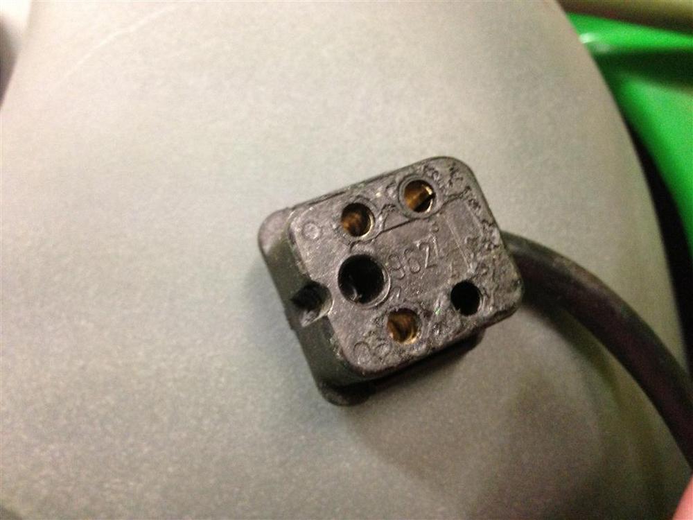

    I am putting a 110 litre repro tank in my ST recreation
    Can anyone tell me how to get the new sender working with the old wiring please.

    Looks like the gauge sender wire goes to the brass terminal, a ground spade will need to be mounted with one of the attachment screws (just like the oil tank sender) and you don't get the third wire which was for the warning light.

    Do you need to get the instrument adjusted so it reads correctly with the 110 litre sending unit?
    I have wondered that also guess we will find out when I fill it and empty it with it all connected??

    Shouldn't be an issue. The resistance values in the various senders are consistant. It will read 1/4 full when the 110 litre tank has 27.5 litres remaining just as it would read 1/4 full when a 60 litre tank has 15 litres...
