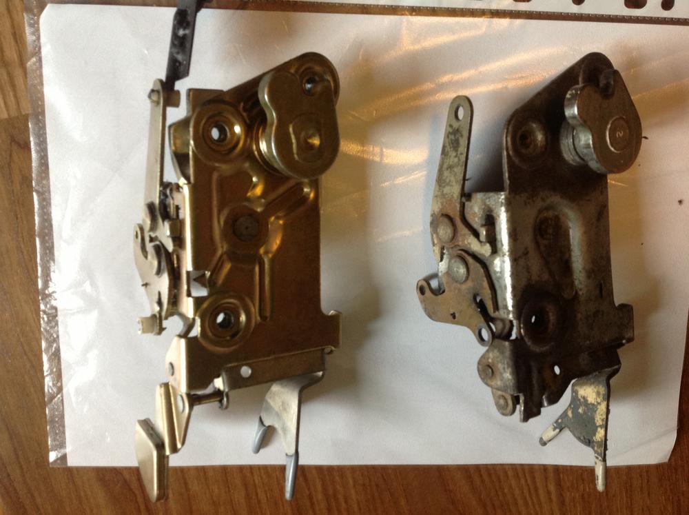

    Installed a new drivers door lock mechanism. I bought the lock from http://www.v-zweeden.com/ in Holland. They assured me the lock from '92 would fit my 1970 T. Despite the obvious differences in the pics and being horrified when I opened the box due to the obvious differences, it slotted straight in and looks pretty much brand new, although it was EUR 100 vs a new one for EUR 600. The only change that made a difference in the installation was that the bolts are now 6x16 rather that 5x12. I believe the extra wing is to support central locking. My lock now works perfectly.... I took the opportunity to grease and adjust the windows and replace a worn out window rubber whilst I was in there too. Happy days.

    What was wrong with your old one? It looks like it just needs some TLC ...

    Hi Marco,
    The old one was just worn out. The joints had become loose meaning the exterior lock didn't lock the door properly and the internal pop up button didn't pop up when the key was used and vice versa. Now its out i will give it a clean and see if its salvageable. I reckon a couple of the worn out parts simply need replacing.
