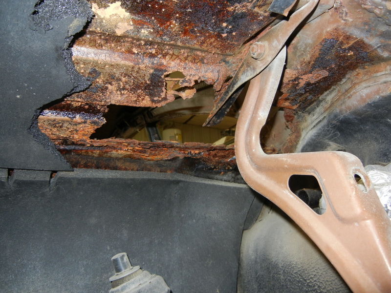

    Since the car was sitting out in the Colorado sun for 10 years, all of the rubber moldings were badly rotten, which allowed water to seep in and the rear interior package panel and the sound pad just absorbed that water. Unfortunately as you will see that was not the only surprise that I found when stripping the car...
    Name:  1972 Porsche 911 (87).JPG
    Since the package tray was completely gone, I figured that I might find some problems in the lower corners of the rear window...sure enough after a little stripping found some big problems. This unfortunately looks too bad to just be a patch, will require cutting out and complete replacement.
    Name:  1972 Porsche 911 (91).JPG
    Another area where water and dirt got trapped and left a nice little rust hole. This also caused the fender joining panel strip to rust as well.
    Name:  1972 Porsche 911 (92).JPG
    And the aforementioned suspension pan, which will need to be completely cut out and replaced. Other minor body imperfections have been found such as a old repair to the passenger rocker and passenger quarter panel.
