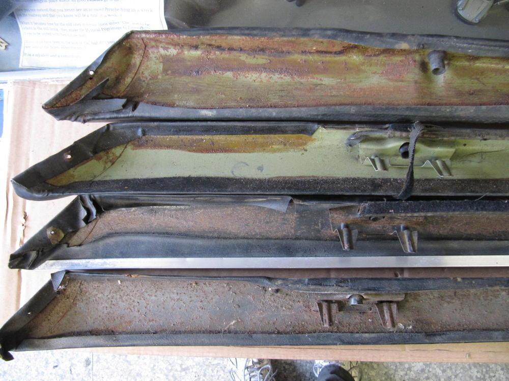

    So, Jim in my picture I show two different 68 door caps. One that is similar to the 67 and flat on the thick end and one that has about a 3/4" inch bend. That leads me to believe there are two different dash pads?

    There is only one dash pad in a 68 that I am aware of and of course it is unique to 68s. Your picture shows, what appears to be a 67 door top on the right. Look at the inside of the door tops near the door lock opening. The 68 should look very similar to the 67 but is wider at the front.

    Here is maybe a better picture of what I think is two 68 door caps, as mentioned above one flat and one with a slight bend.

    It looks like you have a 68 and a 69 or later door top. The "69" one should have more padding on it and it doesn't have the shark's teeth on the inside around the door lock button.
    Picture # 1 top to bottom
    69 (notice there are no shark's teeth)
    68
    67 911S
    67 911/912
    Picture # 2
    Left to Right
    69
    68
    67 911S
    67 911/912
    Picture # 3
    top is a 69 or later door top with no shark's teeth
    Bottom is a close-up of a 68 with shark's teeth
    Jim
