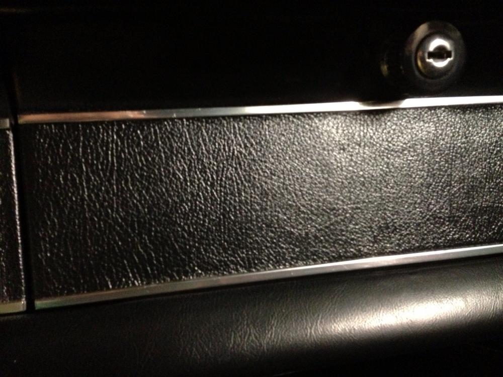

    Is this the correct grain leather for a 73.5 dash? If so, can anyone suggest where to purchase more of this specific material?

    The dashes are typically vinyl. The reason they are not leather (my car came with 'full leather' which meant a vinyl dash) is that leather will shrink and warp and distort the dash. Leather looks classy but the seams will give it away as non-original. There is a manufacturer in Germany making the proper replacement dashes which are a dead ringer for your original (I have one and so does a friend). There is a dash thread floating around here with more info.

    Check with Tony at Autobahn Interiors in San Diego,CA

    The dash covering on my 73 911 is leather. Just in the process of replacing it. Went to a large leather company, brought the original with me. Found a perfect match.

    Thanks for the tips
