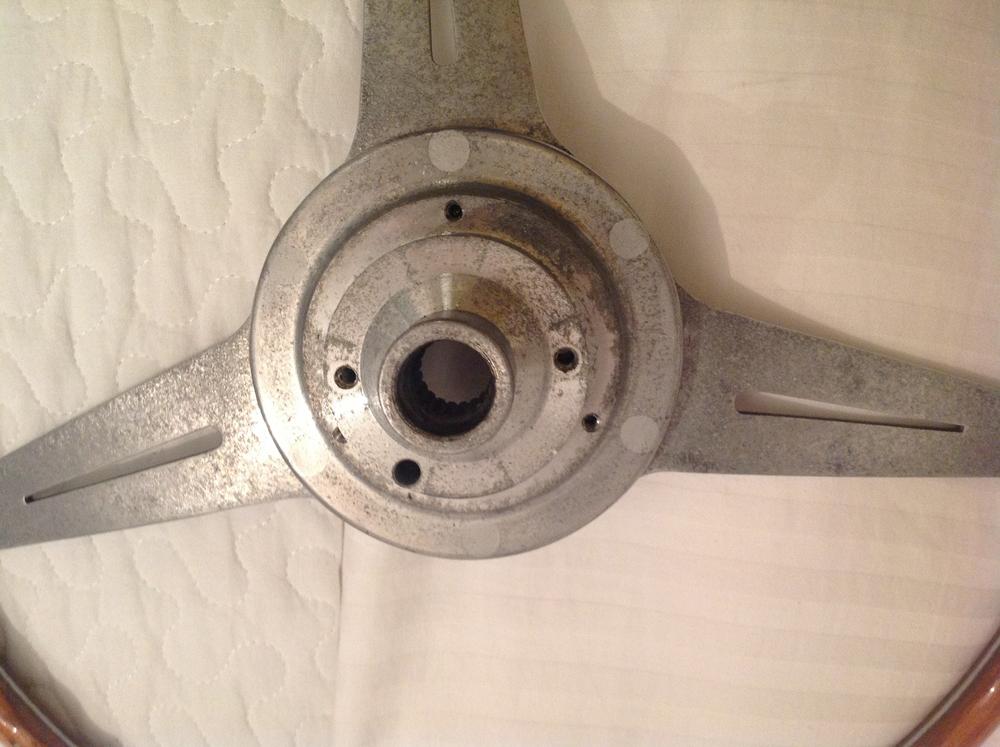

    I have a nice 400mm Nardi steering wheel that would like to set up in a 1969 911. The problem is that it has the hub built in. I believe it is for a Mercedes, the spline size smaller than for the 911. Is there a way to adapt this wheel to my car?

    The easiest thing is probably to find a hub and adapt it to your wheel. I think classico wheels has made some hubs so they can probably help. The difficult route would be to have a broach made and broach the splines in the existing hub. Hope this helps.

    This is another picture of the wheel looking at the back. It looks solid. I don't know where the hub will attach?

    I think you'll find that the hub is rivetted to the wheel then the heads of the (countersunk ?) rivets are machined flat & polished.
    You can see the 6 rivets around the circumference - these will need (carefully) drilling out.
