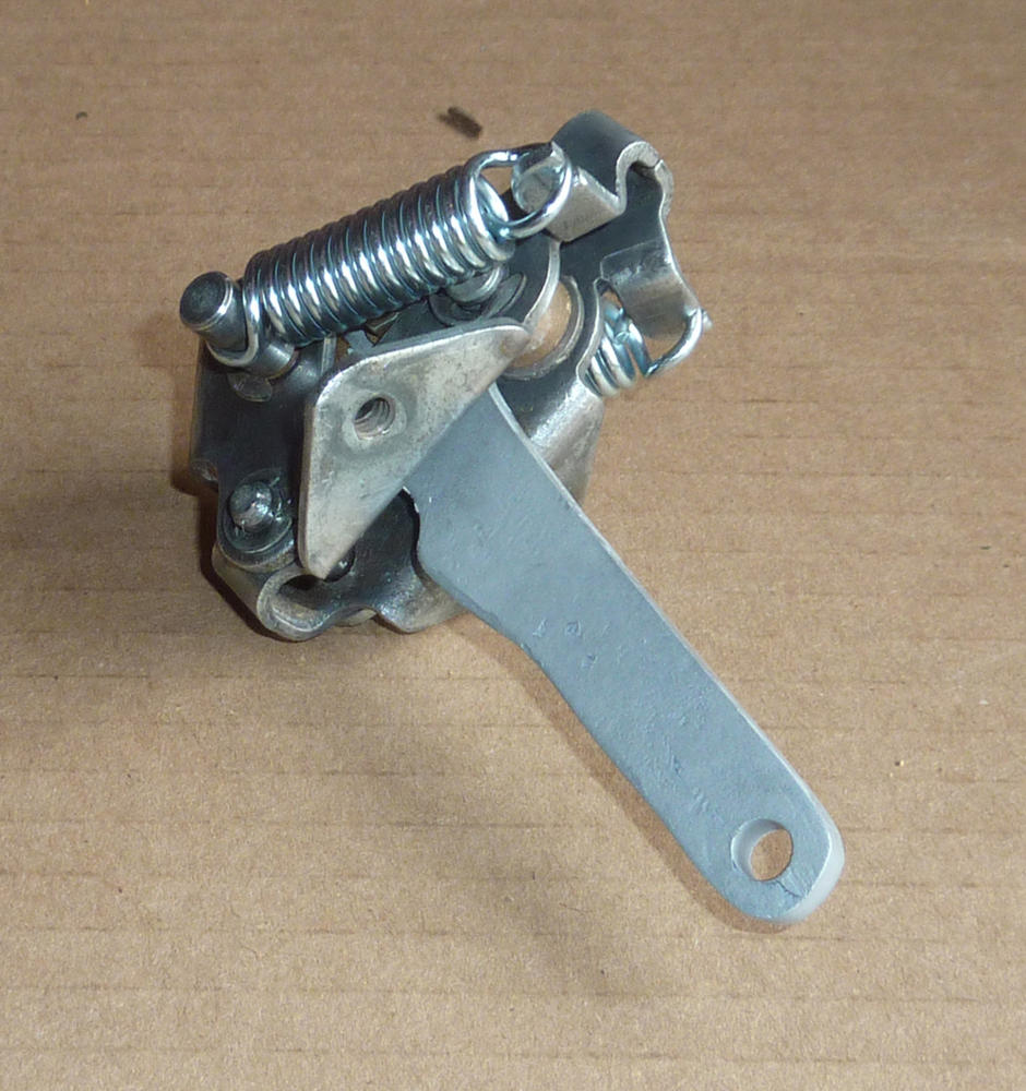

    1970 targa door stay
    Scott,
    My '70 targa came with the 1.5" aluminum 'cam-arm' type. Here are a few pictures. First an exploded view with original parts. Second and third are different views after cleaning up and replacing springs and bushings (with off the shelf parts from the local hardware store.) I can't remember where I read it now, but I recall that this type was used on 914s for a time too, so it may be possible to find used ones to refurbish.

    My '71 Karmann T and my '74 914 both use these.

    Thank you for the info!
    Appears our particular version of 1.5"/Aluminum is NLA. The pics will really help to rebuild mine.
