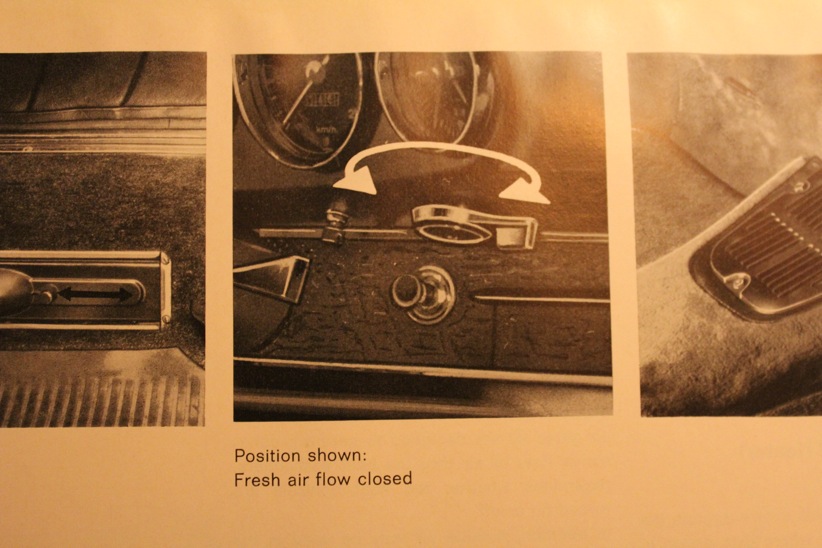

    The knob/lever that operates the fresh air inlet flap: when rotated to the left, does this open or close the flap?? Thanks
    Brian

    Can someone please check an owners manual (or their car)?
    Brian
    S Reg #1032
    My 67 912 operates as follows:
    Full right - little bit of air.
    Full left - little bit more air.

    I believe full left is closed, full right is open. (My manual is not available) Typically these leak due to the rubber flaps shrinking over time.

    I do not remember left or right But this is what the manual says..
    Name:  Fresh air knob.JPG

    Quote Originally Posted by Haasman View Post
    That is what I also thought before I checked the manual. The pic is from a 68 manual, but should make no difference. What is correct??

    The manual is correct.
    I installed the complete nos system 2 weeks ago ( rubber flap, cable, knob, etc) and the system works perfectly : in the position showed by manual the cable is completely pulled and the flap is closed. If you rotate it to the left , the knob push the cable that is guided in a bowden system, and the flap make a 90 degrees turn , so the fresh air can enter from the top.
    Hope it's clear....
