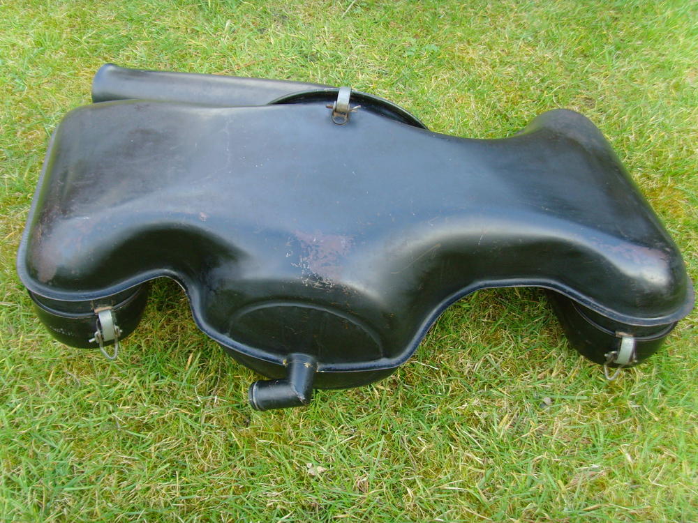

    I'm rebuilding a 1969 911S engine for my 1967 911S Targa project and using Webers on the engine. I do not have an original air box and cannot find a diagram with all the required items to make this project complete. Yes, an air box is obvious, but how does it attach to the Webers? And what type of air cleaners does it use? I know I can go with a K&N set up, but I want to stay as original as possible.

    Hi
    Photos attached of a Weber set up (bases, top and funnel). For '67 and '68 the Weber set up had clips as shown in these photos, these are harder to come by, you will see plenty of later ones where the clips are all wire and the funnel attaches with wing nuts at either side but these would not be correct for your application although they would work fine.
    If you are struggling to find the correct set up I have the bases and top but no funnel, however I am in the UK so probably best to try and find closer to home.
    Hope this helps.
    Tim
