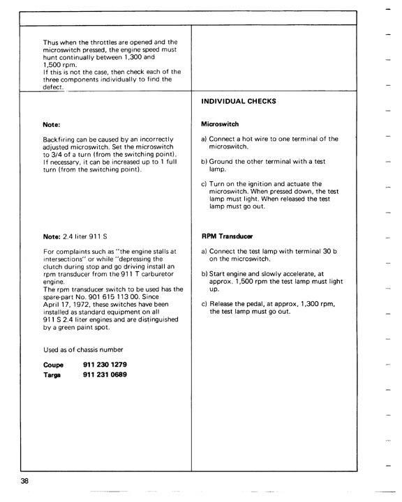

    My thanks to all of you who replied. For the benefit of others who might search the forum and come across this thread, I've included a copy of CMA page 38 mentioned above. Also, following is Wayne Dempsey's description of the switch and its importance & adjustment:
    "The shut-off solenoid is used to stop fuel delivery when the engine’s RPM is high, yet the accelerator pedal is not pressed. This occurs when coasting along in gear, most commonly down a hill or along the highway. The shut-off solenoid significantly reduces the delivery of fuel to the engine during this moment. Without the shut-off solenoid in operation, raw fuel would be dumped down into the cylinders with the throttle bodies closed. In this condition, stepping on the accelerator can generate a huge backfire in all cylinders. The shut-off solenoid is controlled by a small microswitch linked to the main throttle rod. Make sure that this switch is properly adjusted to be electrically closed when the throttle is completely closed (foot off of gas pedal)."
