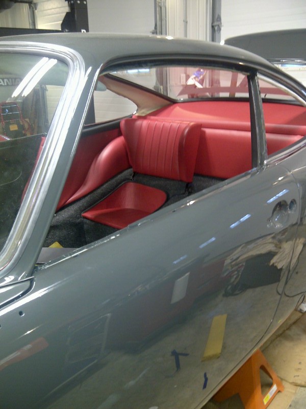

    Great color!!
    Slate Gray, Red Leather, 1968 912 HWT
    That's a better representation of the color in natural light.....
