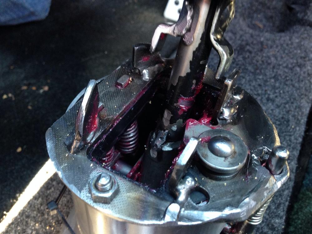

    My buddy just built a gated Seine gated shifter for his 901. His car is not ready and we are going to test it in my car. He used a 915 alum as the base. On the early cars the heater lever is an issue. For testing we are just going to remove it or tuck in in tunnel temporarily. Calling these gated is sort of misleading. They really are not gated like a Ferrari. All the Seine does is reproduce the same tabs that are present for fifth and reverse and uses them on first and second. Or first and reverse for the 901, I think I have it right.
    Another guy I met this weekend at the local car show showed me his homemade gated shifter, cost him his time and $1.29 for spring. He actually used an old accelerator linkage as his link point to the spring. He thought it would be the weak link to his Rube Goldberg design but so far been very strong. It is basically the same as Seine. Seine supply's a complete shaft, which makes more sense. But for a $1.29 hard to beat it.
