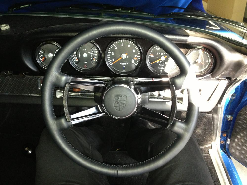

    Port Macquarie, Australia
    1,782
    Here's my 380 with batwing
