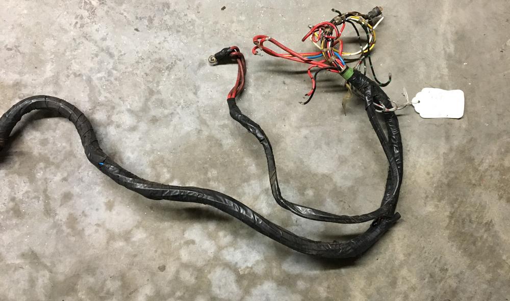

    I have this one available.

    Tom, this looks pretty good. It appears that the front light plug in has been cut off. Is that correct? It's about 6-8" from the fuse box end. And to verify, it's from a 69s? How much do want for it?
    Steve Nunn
    SteveNunnAZ@gmail.com
    Feb 2012
    Kolham, Groningen, The Netherlands.
    131
    This harness is not a 69, but a 71-73 model. Only 69 models have the positive battery wire as a part of the front harness. Starting from 70 its included in the main harness. Only 69 & 70 had a blue-yellow loop for the gauges, starting from modelyear 71 was red-black. A 69 has more relay sockets and no separate female connector for the hazard switch.
