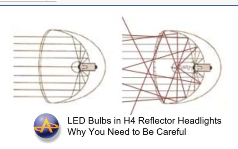

    Name:  leds in reflectors.jpg
    Different Technologies for Emitting Light
    Halogen bulbs and LED bulbs emit light in different ways, which affects their performance in reflector headlights. Halogen bulbs produce light by heating a tungsten filament, which emits a broad spectrum of light including a large amount of infrared radiation. This heat also causes the filament to glow, producing visible light. Reflector headlights are designed to project this light in a specific pattern, using a parabolic reflector and lens to focus the light and produce a sharp cutoff line to prevent blinding other drivers.
    LEDs, on the other hand, produce light through a process called electroluminescence, which involves passing a current through a semiconductor material to produce light. This process produces very little heat and emits light in a narrower spectrum than halogen bulbs. This narrower spectrum of light can cause issues with the performance of reflector headlights. The parabolic reflector and lens of the headlight are designed to work with the broad spectrum of light produced by halogen bulbs, and the different spectral characteristics of LED bulbs can cause problems with the light pattern and intensity.
    I suspect that many of you are familiar with AC automotive lighting consultant and expert Daniel Stern. Daniel is a good friend and also a consultant to Audette Collection, much to our benefit as he is one of the most knowledgeable experts on automotive lighting in the world. I run everything by him and he has great influence over what is included in our catalog, including veto power. Daniel simply does not allow us to sell LED bulbs meant to be installed in reflector headlights designed for H4 bulbs.
    Summary
    In summary, the differences in the way halogen bulbs and LED bulbs emit light can cause issues with the performance of LED bulbs in reflector headlights. To address these issues, manufacturers will need to engineer LED bulbs that produce a light spectrum similar to that of halogen bulbs, and modify the design of the reflector and lens to work optimally with LED light. With these modifications, LED bulbs can provide a more energy-efficient and long-lasting alternative to halogen bulbs in automotive lighting.
    To make LED bulbs work properly in reflector headlights, manufacturers will need to engineer the bulbs to produce a light spectrum that closely matches that of halogen bulbs. This can be achieved through the use of special coatings or filters that alter the spectrum of the LED light. In addition, the design of the reflector and lens may need to be modified to work optimally with LED light. Manufacturers will also need to ensure that the LED bulbs are properly aligned within the headlight assembly to ensure that the light pattern is correct.
