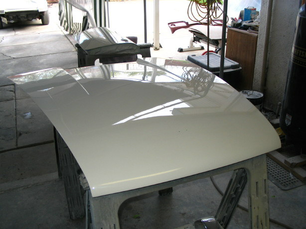

    Here's a pic of my hood. Like the shine?

    You need a bit more wax on there...it does not quite reflect like it should
    Love that photo!

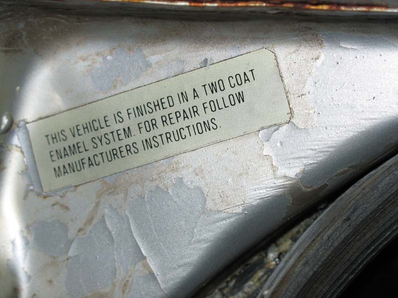

    I have just got a Silver 73T in for some repair work today and what do I find? A sticker declaring the paint is 2 coat! Chuck was right all along.
