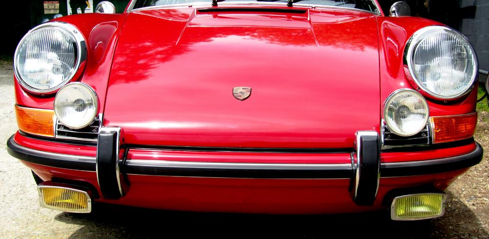

    Here is my car's lighting setup. It is exactly as the front of your car would have looked from the factory, aside from RHD lenses on the H1s and Euro turn signal lenses. Same paint color too...
