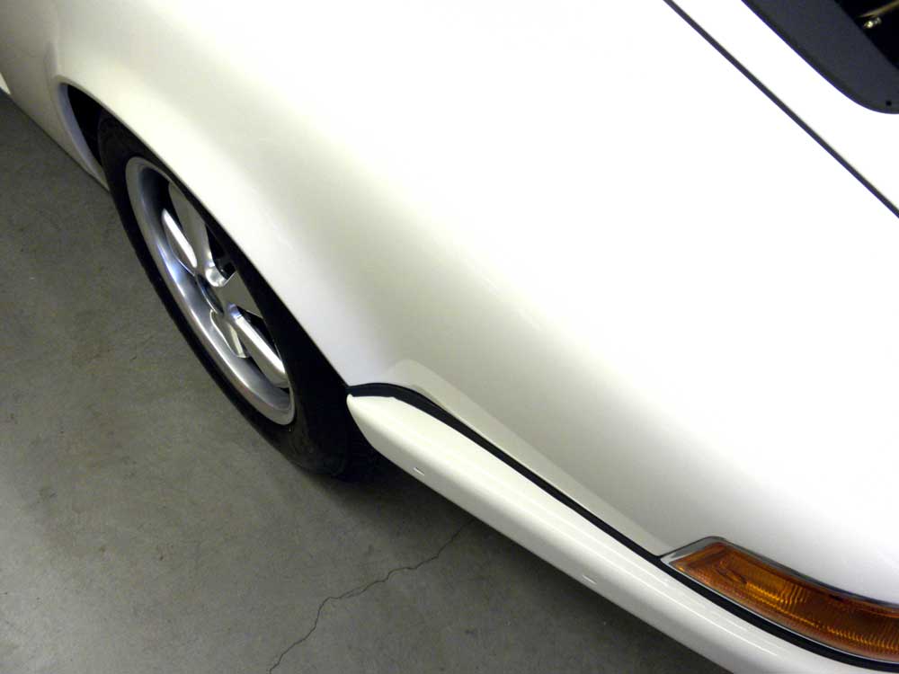

'Unpolished aluminium rims'
The 1968 Sports Purposes document lists 'Unpolished aluminium rims' as part of the specification and the early photos of the car clearly show the unpainted wheels (see first photo); what we didn't know was what constituted 'unfinished' other than the absence of black paint.
Standard wheels receive machining/polishing that rounds the petals as shown on the standard deep 6 in the second photo.
The original wheels had received a couple of crudely applied layers of paint during their time in Uganda (although this probably helped to protect them) however the team at Canford Classics carefully removed this paint to reveal the bare state. We found that the 'unfinished' element was that the machining/polishing that the normal Fuchs receive was not undertaken as you can see in photos 3, 4 and 5. We believe that this more basic finish was then just anodised to give the Sports Purpose 'unfinished aluminium rim'.
