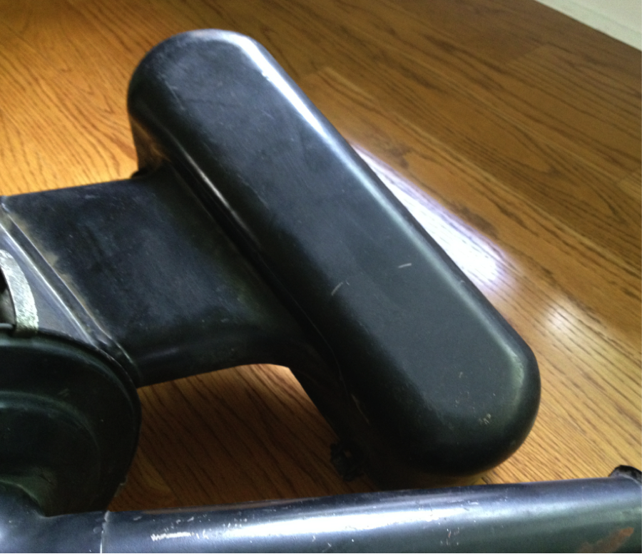

    I've noticed that most Solex air boxes have the wedges at the ends of the carb covers (first pic). I have one that is rounded at the ends (pic 2-4) with what looks like a factory sticker on the snorkel.
    In "Excellence was expected" the 64 911 engine picture has a rounded air cleaner (no wedges) like this one. Does anybody know if the rounded version was a first version and the wedges then came later? Purpose of the wedges?

    The rounded one is the first type on a '64 car and the other came a little later on the '65 cars give or take a few. That wedge is for clearance.

    Regarding clearance that's what I thought as well (although I thought internal airflow might also be a reason). It must be "extra" clearance though as I don't believe anything substantial changed on the underside of the engine lid and I'm guessing this box will work on any car running solex carbs.

    Hard to tell from your pictures, but, I think the smooth housing is shorter than the one with the wedge. So, PORSCHE changed it for some reason!
