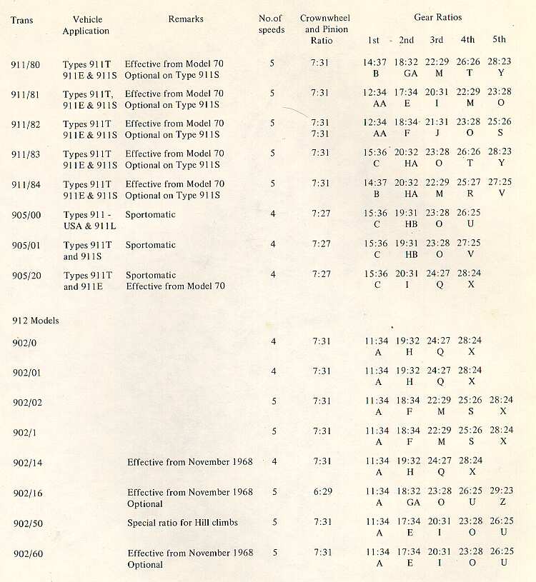

    Here are a couple charts.
    Chris

    my chart for this trans
    902/1 from 220001 to 221721 912 ending 1965 07 26
    902/1 from 221722 to at least 232398 911 & 912 1966
    902/1 from 234001 to 238942 912 1967 5 speed
    902/1 from 130001 to 131571 911 1967 5 speed
    902/1 from 3280001 to 3281317 911 1968 5 speed
    So only in 1966 was this trans shared between the 911 & 912 from the same serial range, otherwise each model had it's own serial range.
